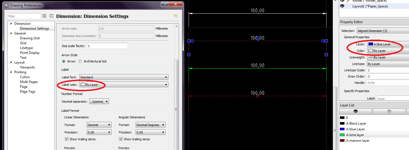

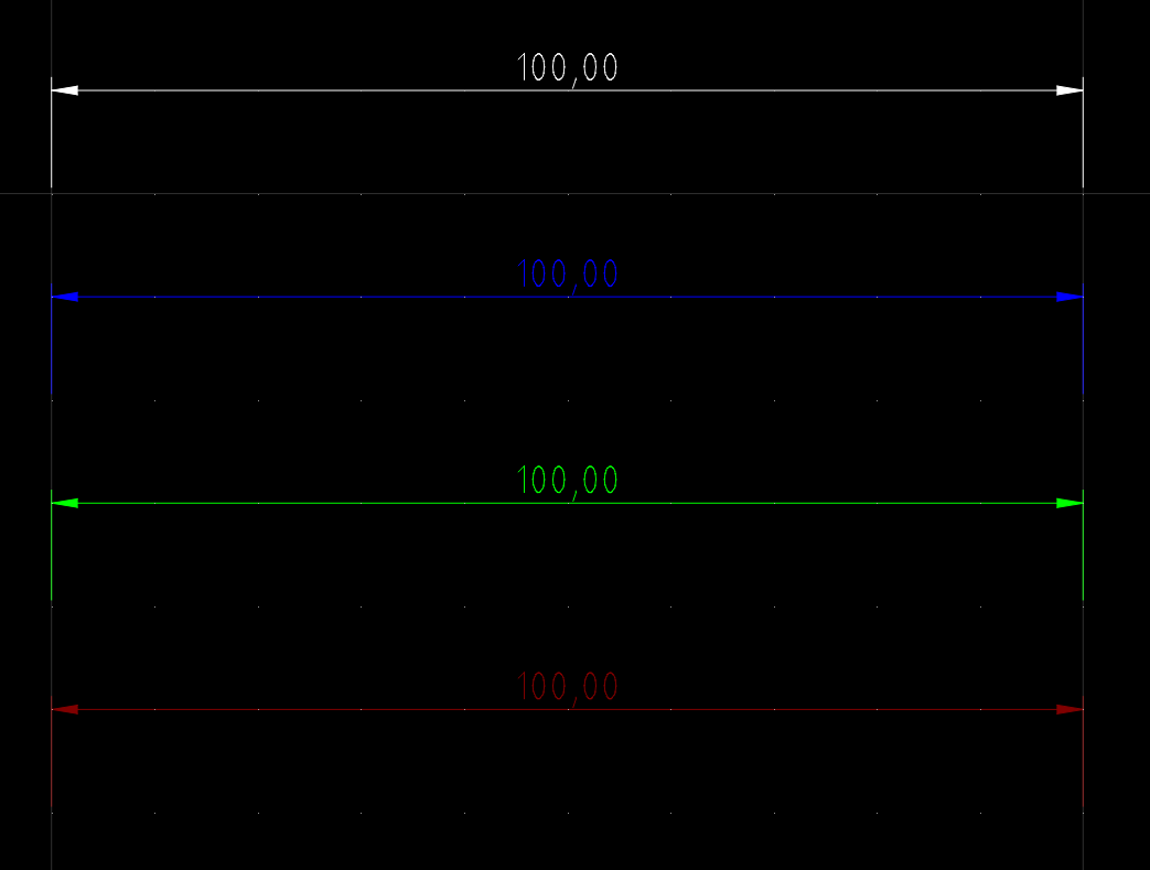

All,
After update to 3.26.2
How can I get the Dimension text back to byLayer?
Black DIM text.png (74.52 KiB) Viewed 15095 times
DimTextColorPersistent.dxf
(102.88 KiB) Downloaded 904 times
Thanks,
CVH

In your dxf I just opened you have the dimension text, or label colour set to BYLAYER, ie all elements in the four dimensions display the BYLAYER colour.
Pete Vickerstaff
Linux Mint 21.3 Cinnamon, Qcad Pro 3.31.1
CVH
Premier Member
Posts: 4959
Joined: Wed Sep 27, 2017 4:17 pm
Re: How to get ByLayer Dim text color
Post by CVH » Mon May 10, 2021 4:15 pm
Thanks, Pete
:shock: Bummer, clearly mine are not. :cry:
Thanks for trying out,
CVH

And what about lineweights and very bold text.
015 is rather common on A3 .... Confused.
Text is hardly readable.
pdf included.
DimTextColorPersistent.pdf
(11.09 KiB) Downloaded 922 times
pdf included.
That is weird. All I can see is that layer 0 lineweight is 0.25mm, with your dim text being white is it possible that the text is on layer 0 :shock:

Correct, dim text can't be on a different layer.
Nor that changing layer0 weight has any influence.
Nor any other layer its weight.
Nor layer0 compatibility.
Thanks for thinking out loud,
CVH

There was nothing mentioned about dim text colors, so I disregarded that bug report.
Render text as text is my default.
Even my oldest file uses font 'Standard' & byLayer.
Seems I have tons of files to update to what is called 'default'.
Will be busy for a while :lol:
