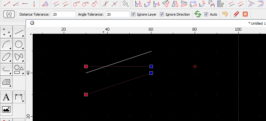

This is even rather or very dangerous in complex designs!
In this example the horizontal is not selected by angle tolerance but by distance !!!
I presume 'angle tolerance' is for arc segments ... ?!
In Husky's example a value of 35 or so would select almost every entity.
'Overlapping elements' also means that only two ends overlap.
MD doesn't catch those.
'Unify overlapping elements' means they are converted to one single entity.
MD only selects those found by the fuzzy criteria.
One can erase duplicates found in one (too easy) click.
