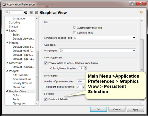

Try this and see if it helps, go to Main Menu > Application Preferences > Graphics View and 'check' Persistent Selection - this should keep your selections 'persistent' including all tool selections and snaps until you either 'double right click' or click on the 'Reset/Idle icon' (top left hand corner arrow icon) or enter QQ in the command line.
*Note with Persistent Selection activated you will need to use the 'Selection Tools' ( keycode - WS) tools to de-select (Deselct All - keycode TN) your highlighted 'selected' entities!
I hope this makes sense to you, I`m sure you`ll soon pick it up, most of the time you won`t need to activate persistent selection - but sometimes it`s useful.

- Persistent Selection.png (121.99 KiB) Viewed 67460 times
