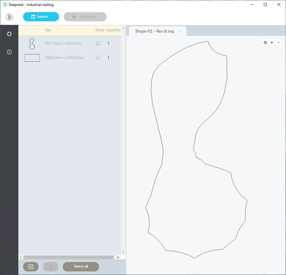

Just tested with quite a few parts and it worked great, apart from this file, somehow it seems to of reversed some arcs? any idea what might be going on... it's in metric, was going to nest on a 2400x1200mm sheet...see picture and attached file..
