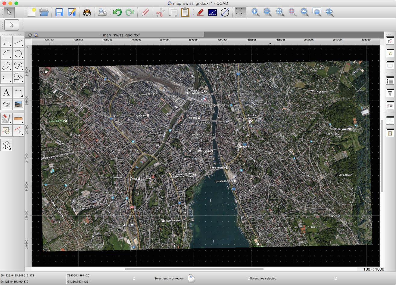

Positioning and Scaling the Map
- Select the inserted map. You can do this by clicking close to its border. The map is now surrounded by a red rectangle to indicate that it is selected.
- Choose Modify > Align Reference Points
- Disable auto snap by clicking on the Free snap button at the left and make sure that the tool option Scale is enabled.
Screen Shot 2015-09-10 at 09.38.26.png (82.01 KiB) Viewed 94141 times
- Click the first reference point A in the map.
- In the command line, enter the known position of point A and press enter:
681360,248194
- Click the second reference point B in the map.
- In the command line, enter the known position of point B and press enter:
684937,245692
Screen Shot 2015-09-10 at 14.56.38.png (1.91 MiB) Viewed 94139 times
Notes
Be sure to verify the result by measuring different locations and distances in the map before using it. For larger areas, this method will not yield precise results since Google Earth shows the earth as round, viewed from top without any map projection applied. Google Maps uses the Web Mercator projection.
