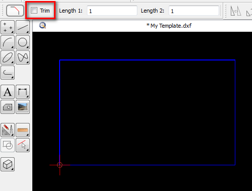

You can leave the 'Trim' field unchecked and clean up your drawing at the end.
Bevel,Chamfer - Trim.png (15.7 KiB) Viewed 9522 times

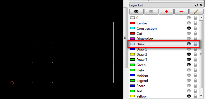

Original layer.
Layer Draw.png (18.9 KiB) Viewed 9522 times

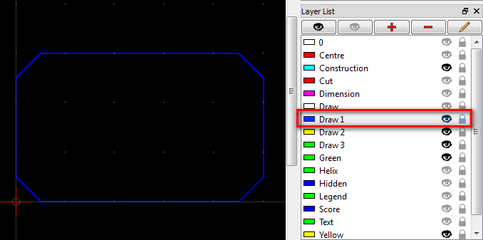

Changes made on new layer 'Draw 1'.
Layer Draw 1.png (18.28 KiB) Viewed 9522 times

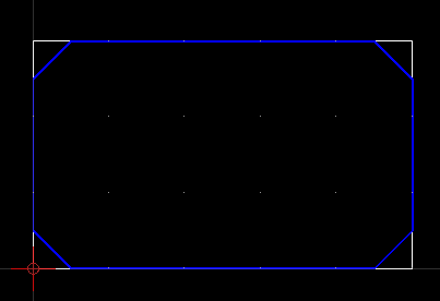

Both layers visible.
Layers Draw and Draw 1.png (1.37 KiB) Viewed 9522 times
