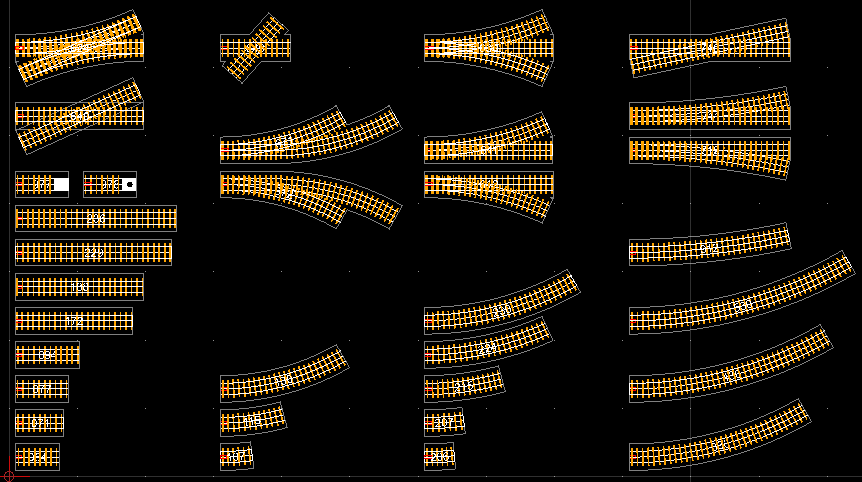

libraries for QCTrack
Attached are example libraries containing track elements (and some example plans) for Märklin H0 C-Gleis, Märklin Z miniclub and Ninco slot car tracks.

Tutorial step 4: create your library
As described in step 2 and 3, create all your track elements, insert each block once and save
this file. For Maerklin C-System tracks, you get something like this:
Of course, for Maerklin C-System tracks you may just download my library MaerklinCGleis.dxf from the post above.

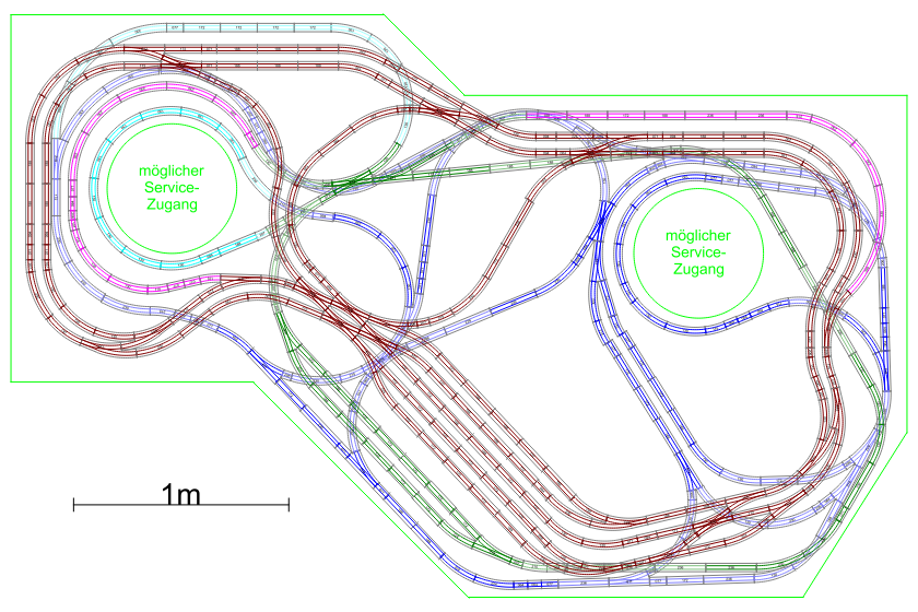

example plan
Attached is a dxf example plan for Maerklin C system which looks like this:
- Attachments
- example.dxf
- Märklin C-Gleis example plan
